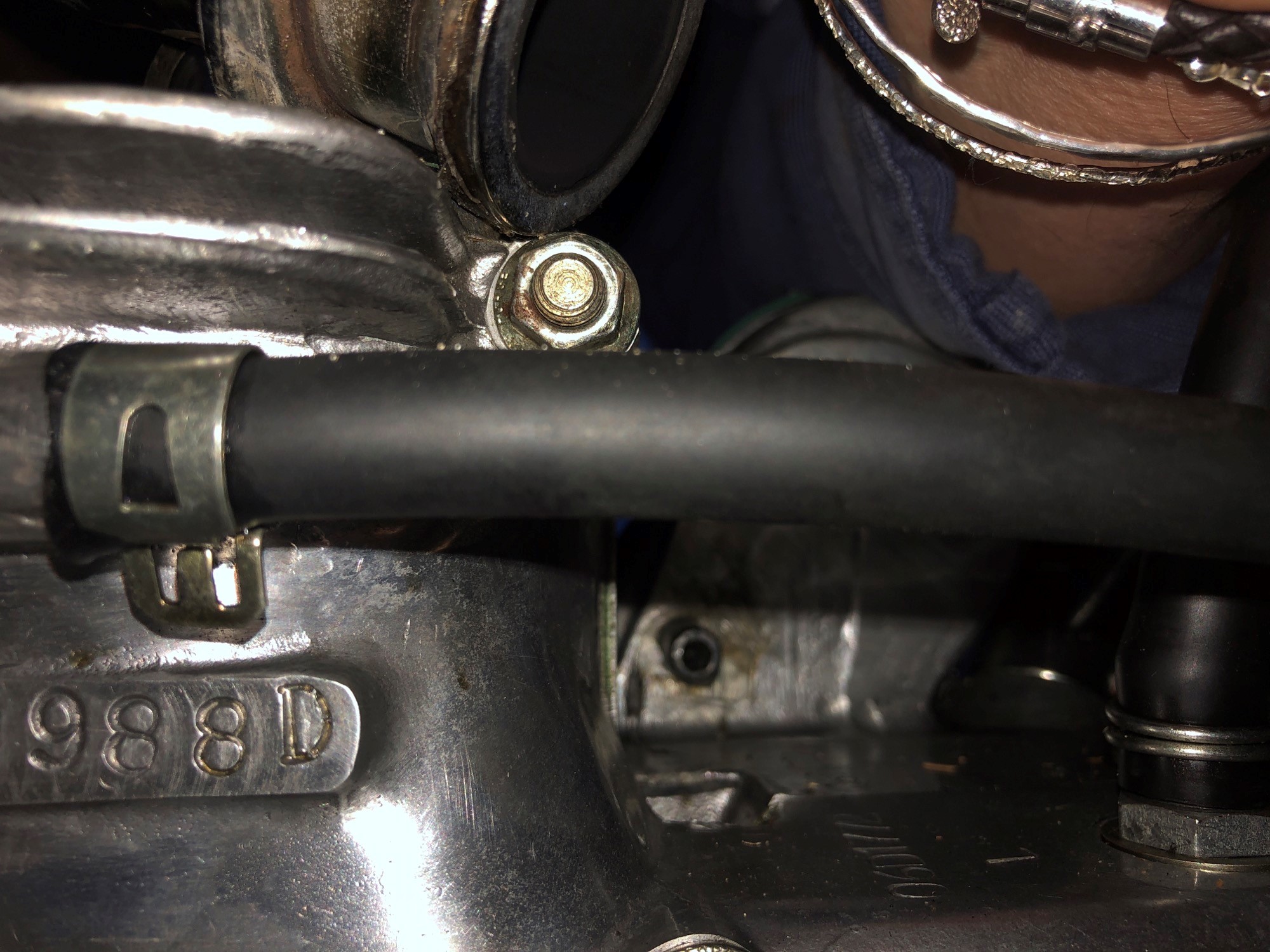

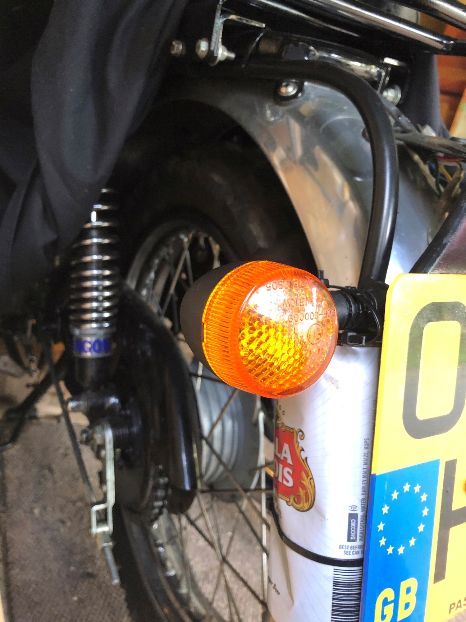

I have an ongoing issue with it too and as Adrian advised lost of posts on here about it. I have done two things, firstly opened up the spigot on the crankcase (if yours has one) and also added the pipe as Adrian advises, to be fair neither has solved the problem and I know it needs a rebore so blow by it is! See attached needed a Stella can to catch the oil!!!
There is drilled hole high up above the oil level between the crankcase and oil tank, this is where the excess pressure comes from into the oil tank from the crankcase if you have blow by, there has been conversation on here about welding the hole up and only using the crankcase spigot as engine breather.
Good luck ;)
