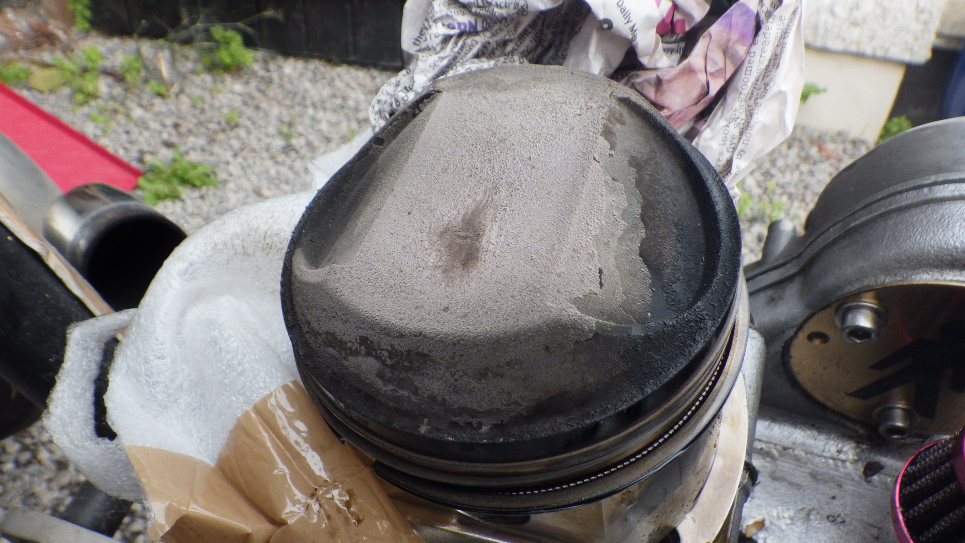

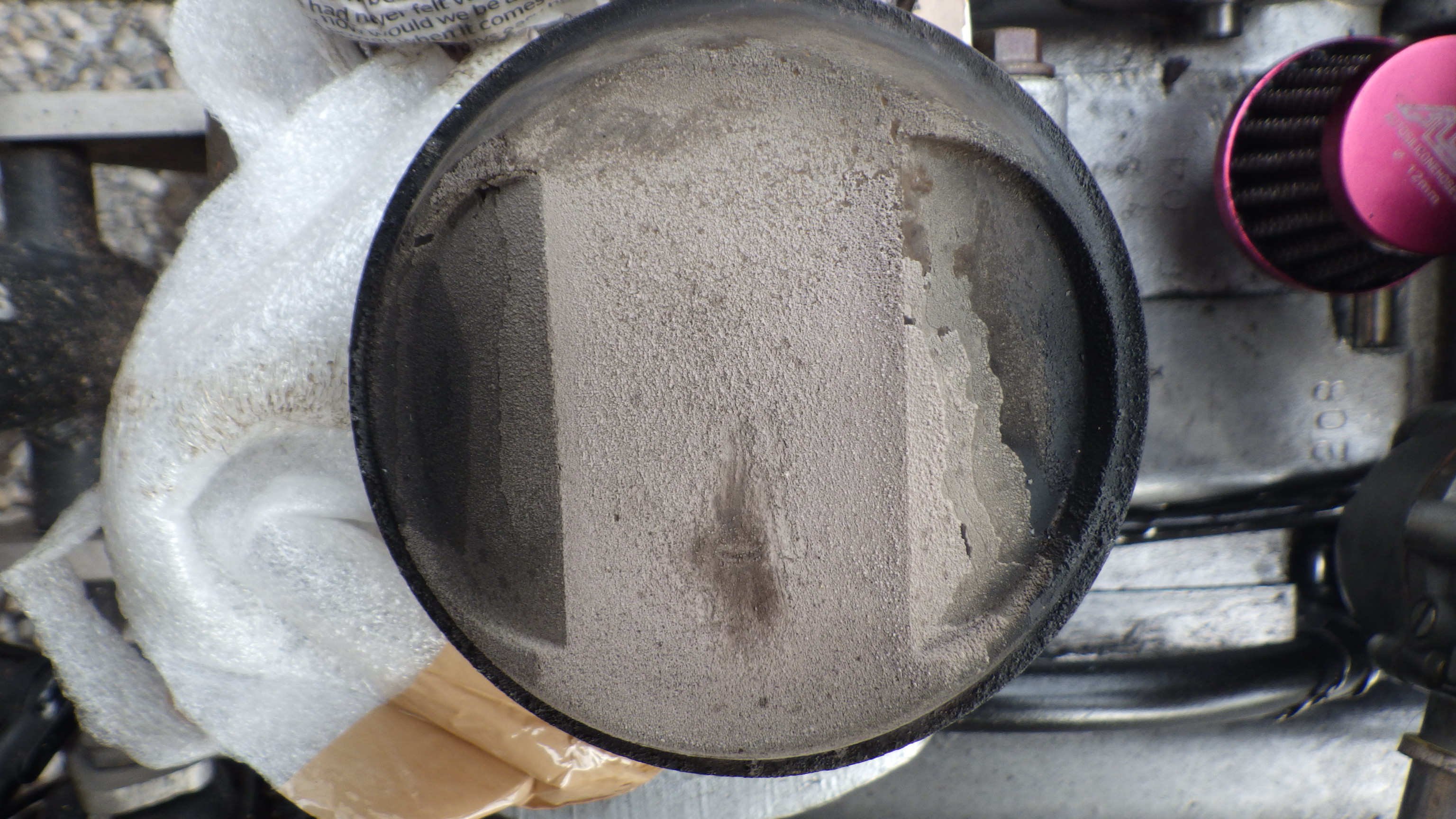

I've pulled the top end off my 612 bullet after 2500 miles to take one of the compression plates out. I put both in initially for the shakedown/run in.
This is how it looks after a prolonged period of sitting at maximum cruising speed.
I'm thinking slightly the lean side of ok? Maybe up one main?

Has that touched the spark plug?
Strange mark the middle.?
#98111
That was the dead stop tool marking the carbon on the sufrace of the piston followed by me picking at it with an oily fingernail to see what the funny mark was.

#98114
That looks like a pretty clean and even burn to me, but you might want to jet up a little for the increase in compression you will have with that barrel spacer gone.

I'm running it on super anyway, tends to pink a little on 95 octane.
I tried going up to a 240 main (from 220) because I had one. That was rubbish, worse than befoe I took out the plate. Then I went back to the 220 and raised the needle a notch and it turned into a racebike sounding rip-snorter with a proper "Rhuuu-barrrb" engine note and a significant amount of "seat of the pants" power increase. It just sounds right level of obnoxious I'd expect from a big, high-compression single. I was actually surprised how much difference such a small change made.
