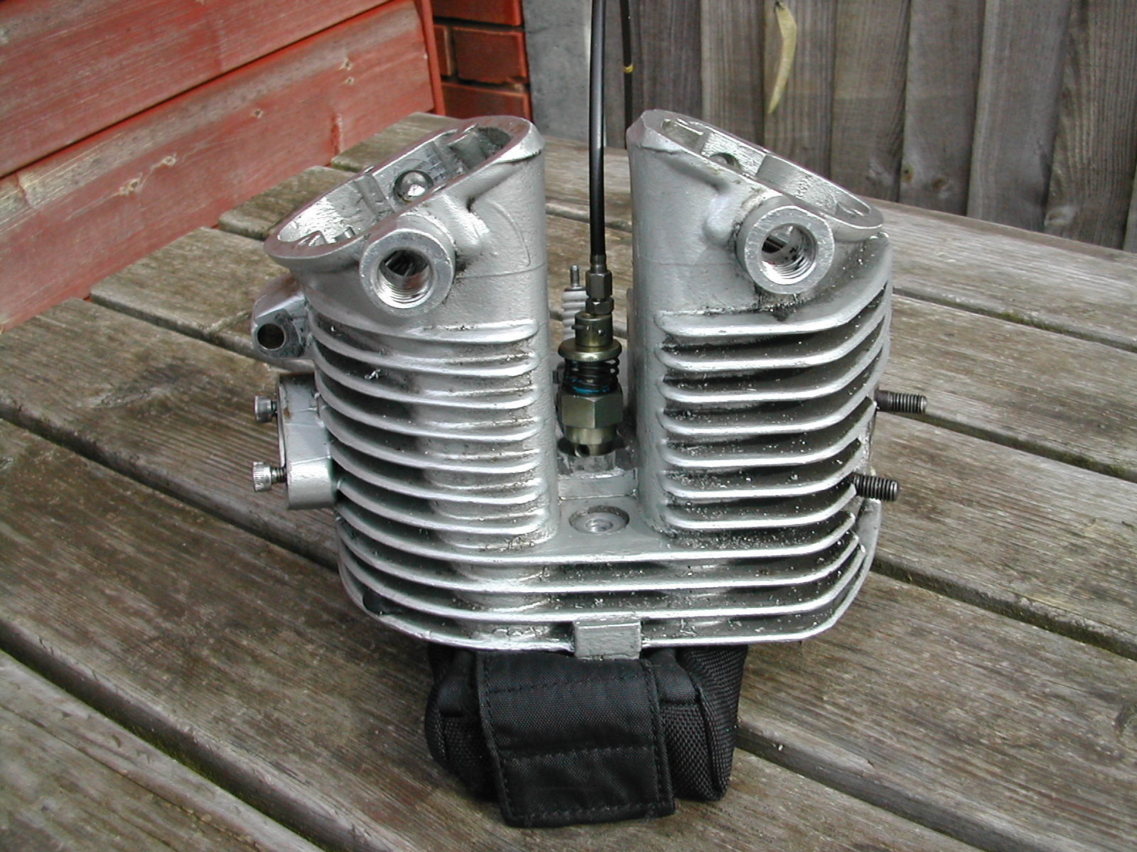

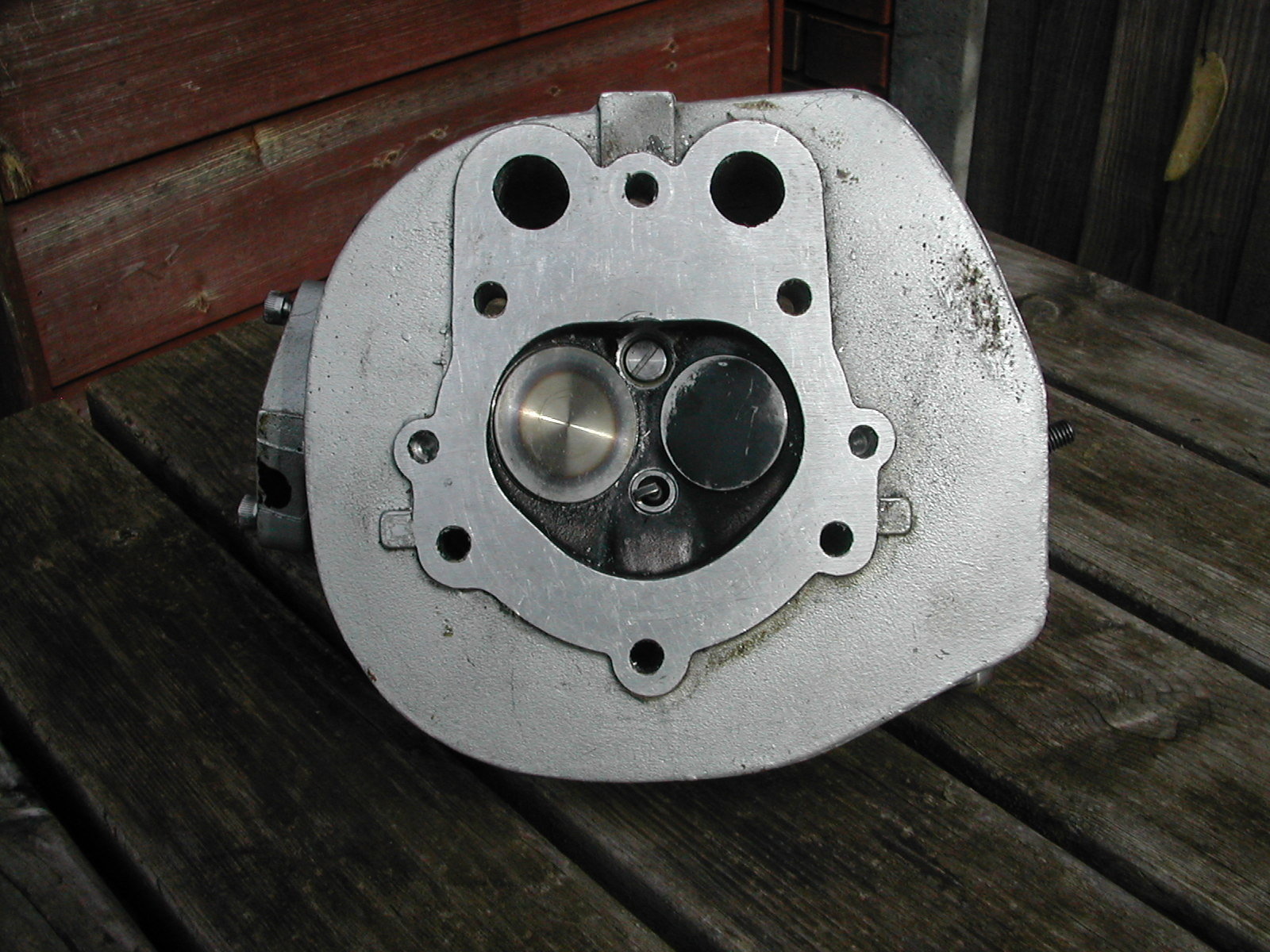

I gather people have had success with the old-fashioned handlebar lever. Failing that, it is possible to modify the 500 AVL cylinder head to take the older Bullet's decompressor valve.

Thankyou for the images Adrian, like the look of the conversation and maybe one day...........!
