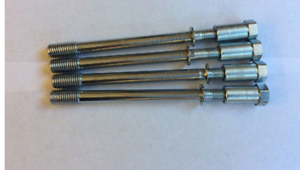

It was the crankcase stud threads that stripped on my Connie. 1st time I fixed it I used a helicoil but did a cock up, it was much too short (though i did buy it from H's & did tell the chap on the phone what it was for) .. anyway i ended up having an insert made at a local engineering shop & since then its been fine . There was someone on here a few years ago who sent me some info on the mods he did to his Connie (sorry cant remember the name) & what he did was have some new "stepped" studs made (3/8 threaded into case, the rest 5/16 as standard)

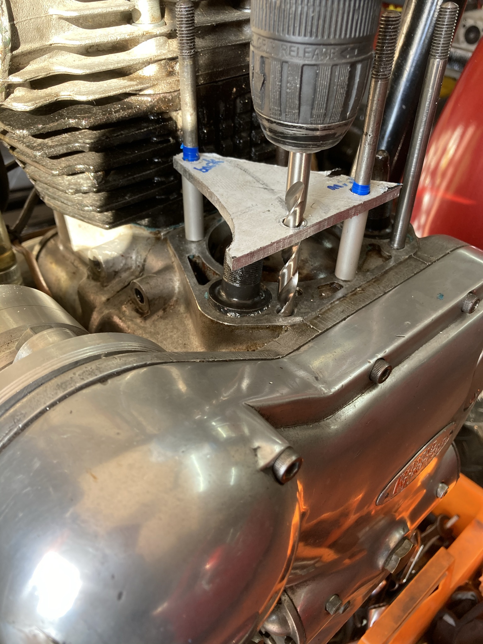

I ordered a Recoil kit from MrH and drilled/tapped the thread hole. Unfortunately the Recoil kit only contained short (1.5D) inserts so paying heed to the advice here I didn’t use these and so I’ve ordered a few 2D inserts. I had assumed the kit would come with a mix of short & long ones!
My main concern at drilling/tapping was keeping the new hole perpendicular to the casing, so I made up a Heath Robinson jig using a piece of scrap Ally and a couple of short Ally tubes to pick up on adjacent stud positions. The blue tape is packing because the stud threads are rolled, the shank is smaller in diameter than the threads
By RocketRR
#95629
If this doesn't work a good trick is to use a T20 Triumph Tiger Cub stud as it has a wider diameter bottom thread than stud diameter. This meaning you get a stronger new thread in the bottom and same stud diameter. Did this on my Connie on the advise from an old Gander and Grey employee in Bristol and it never failed again in my ownership.
