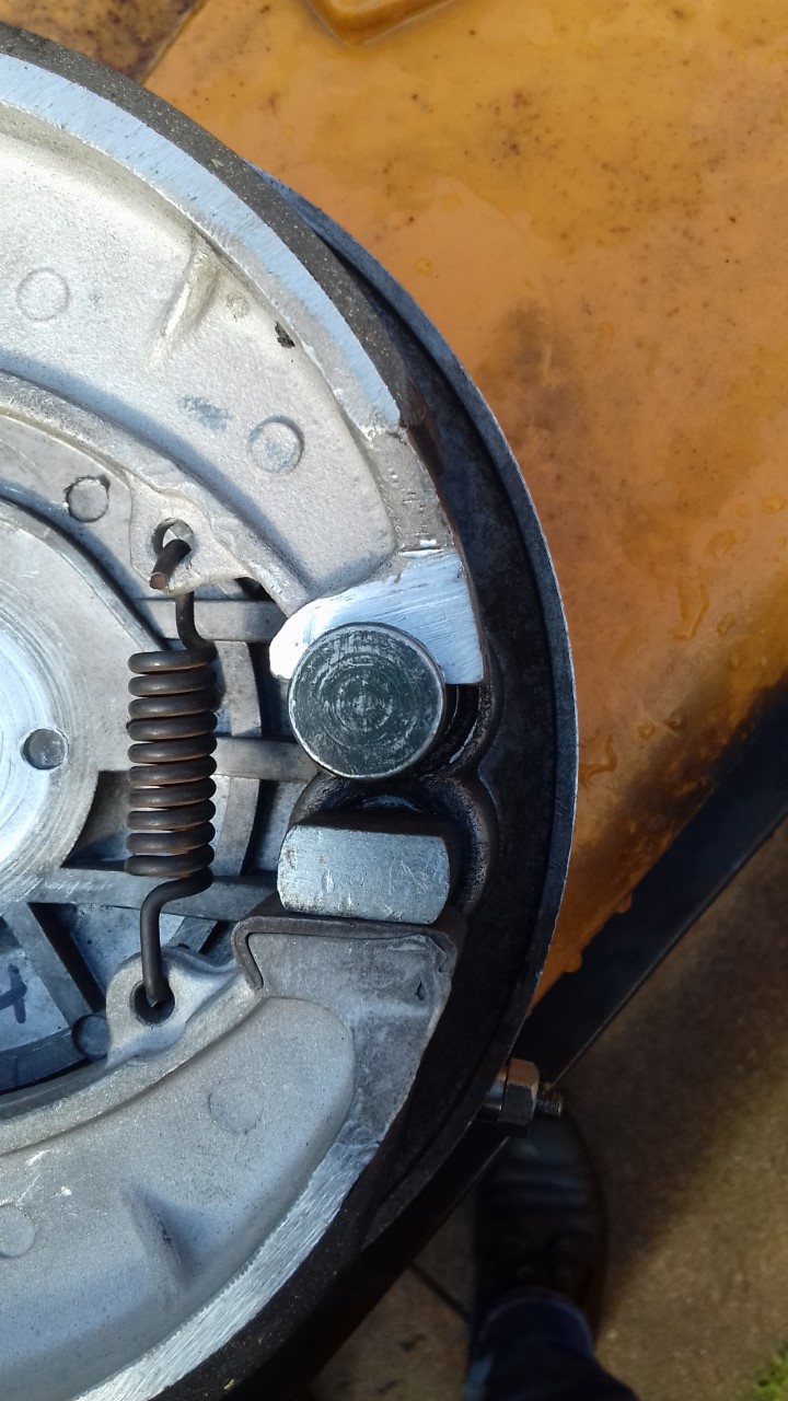

This is a pic of how small i machined the brake cams.. about or less then 50% of original width. so the pressure on the drum must be twice as hard..
Ver soft/graspy linings.. made to fit on diameter and the drum hardly brakes.
Strange thing is, after adjusting first attempt to brake is hopefull, after that braking gets less and less and no, brake does NOT drag, brake comes freely loose every time.

Can someone explain the mechanical logic of this:
I'd have thought the opposite was the case.
'Give me a lever and a place to stand and I will move the earth'
Cut the cam away until there is no cam and there will be no pressure on the drum.
Enlarge the cam to one foot width and more pressure of the drum.

It's about reduction gearing, the ratio between the brake arm and the cam. Long brake arm attached to a short cam = easier to apply more pressure but a larger arc of movement to move the shoe the same distance. Think of a bicycle crank. If you make the crank (brtake arm) longer or the sprocket (cam) smaller, the bike is easier to pedal.
Yes, if you had a cam a foot long, and managed to move it through the same arc, it would apply an enormous pressure but you couldn't use it. To use the bicycle analogy, you could fit a 100 tooth front sprocket and it would in theory go super fast, however you wouldn't be able to move off the spot. Whereas if I fitted a 20 tooth sprocket, it wouldn't go very fast but I could apply an enormous anount of pressure to the rear wheel and ride up Hardknott pass.
