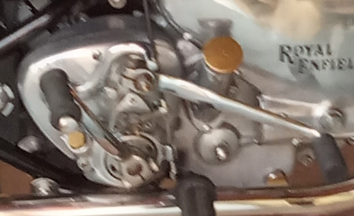

ImageHi guys
My 53 Meteor goes up though the gears no problem.
It comes down through the gears no problem.
The neutral selector works no problem.
If I come to a halt in traffic in first gear I find I cannot move the box out of first gear without either stalling the bike and then selecting neutral and restarting or pulling away without restarting and then the gear box works again... Obviously sitting in traffic with the clutch held in on a hot old bike is not ideal.
Any ideas how I might sort this one out?
REgards
Tom
