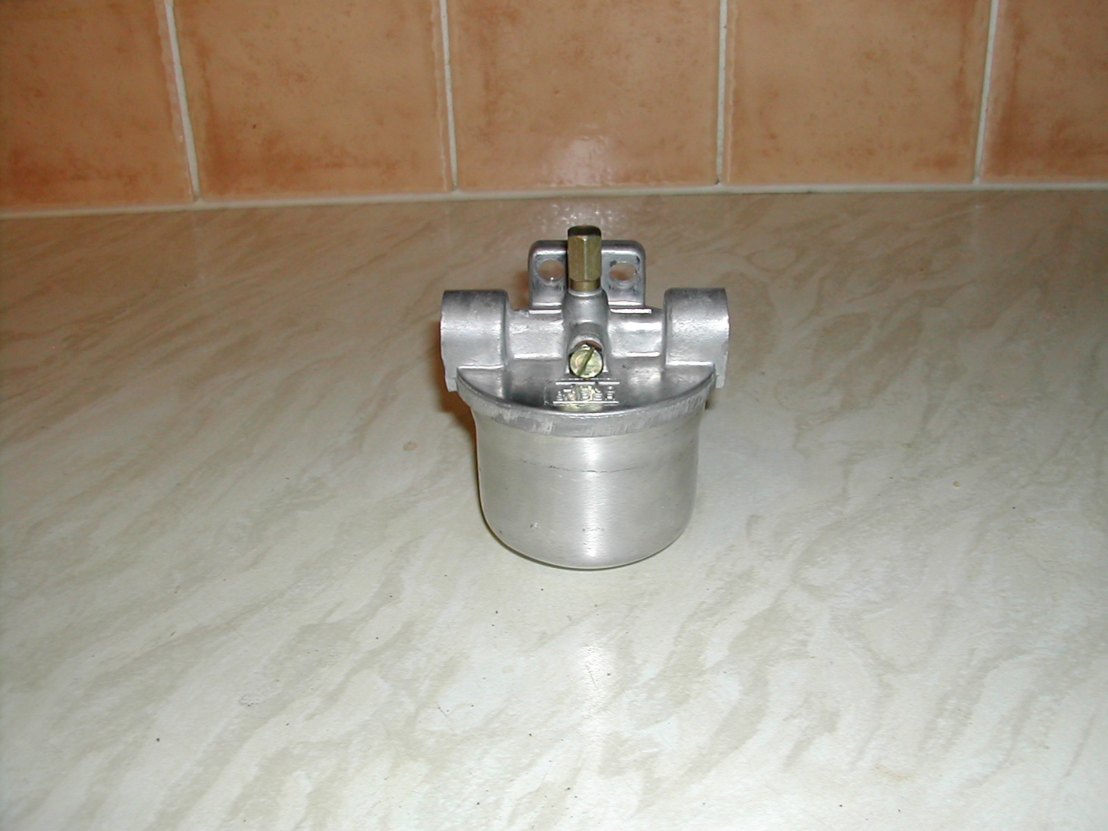

There is nothing to stop you plumbing a Norton Commando filter into the rocker feed line, I have seen pictures where it has been done very neatly, though you'll be having fun with brackets and pipe fittings (the feed pipe stubs on the Norton filter mount are 3/8", the rocker feed pipe is 3/16").
As an alternative to the Norton Commando filter you might get the diesel fuel filter used on Indian diesel Bullets to do the job.
