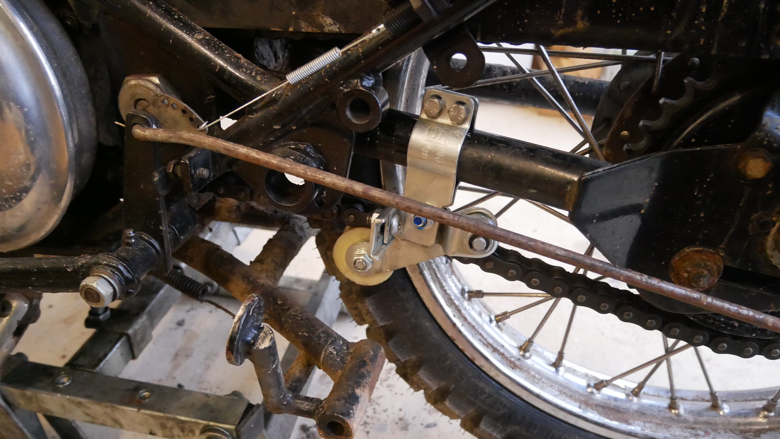

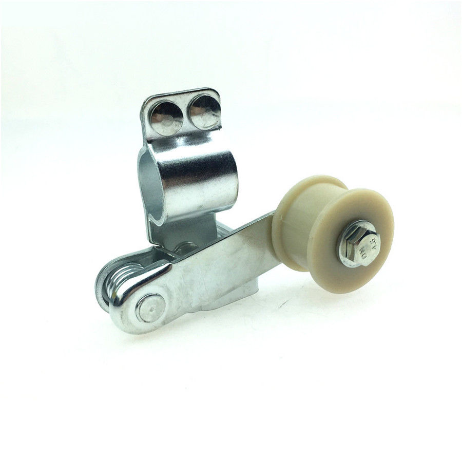

Re chain slider
I have one of these fitted, works well.
From memory it's was a little small, heat from some hot water softeners it and you can re-form the bent diameter to fit perfectly.
