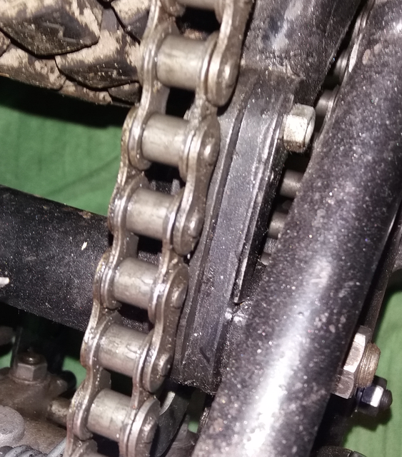

I’m in the process of shoehorning a Bullet engine into a Crusader frame and have installed long shocks to lift the rear and Bullet forks to lift the front. Having just installed the rear chain I find the top run just contacts the top of the swingarm.
Is this a problem and should I somehow fix some rubber or nylon to the top of the swingarm (rather like the bonded rubber on the primary chain tensioner)...?

As you say I’m also going through these questions so I’m happy to share what I’m trying.
For the swing arm area I’ve ordered one of these guards - https://rover.ebay.com/rover/0/0/0?mpre ... 2197524124
I’ll cut it half and use car badge tape to secure it (just because it’s in my adhesives drawer)
To allow for more chain movement but still keep the tension I’ll use one of these - https://rover.ebay.com/rover/0/0/0?mpre ... 4039207137
It’s surprisingly well made for £12 but took a while to walk here from China!
My shocks arrive this week so I see some fettling in the near future

Thanks for both suggestions. I’ll have a proper look and try one!

If you're just after a suitable hard-wearing material then go to your local cook store and buy a cheap nylon chopping board. I was thinking about going down that route but I need to wait until my wife isn't looking :D
