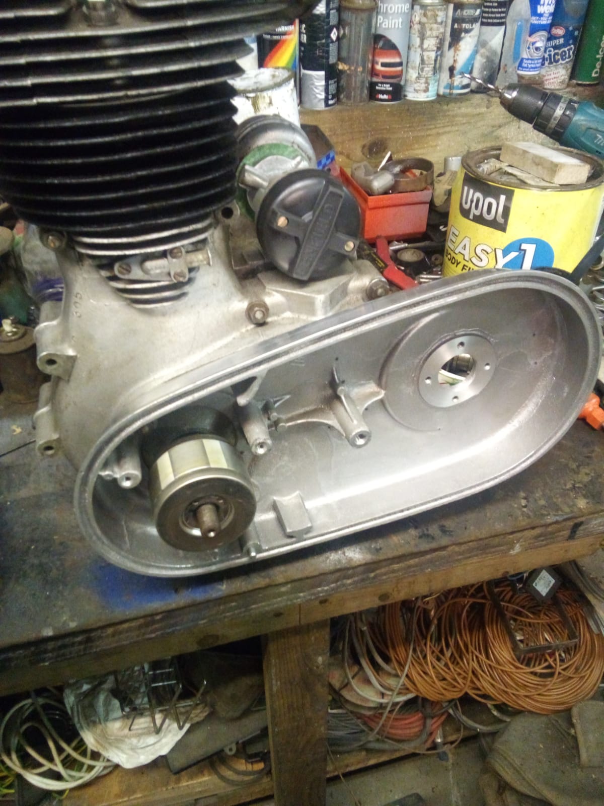

I am in the process of purchasing a 1956 Royal Enfield Bullet 350 bottom-end minus gearbox and alternator.

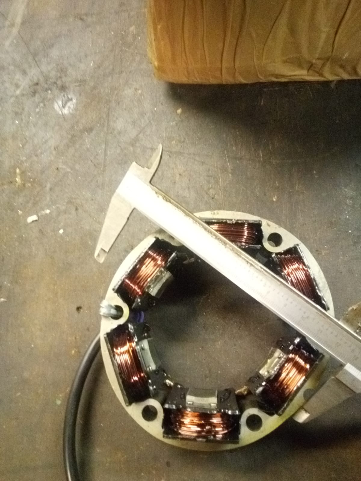

I intend using parts from a 1989 Indian Bullet engine to complete this engine and I am wondering if anyone can confirm that my existing Indian alternator will fit.
I am particularly concerned pegarding the fit of the rotor onto the crankshaft as I believe that the Reditch and Indian cranks are a diffent diameter.

#87297
I don't THINK the rotor fitting is an issue. The lucas rotors (part: LU/54213901) is listed as fitting both reddich and Indian models.
Where you might run into issues is with the clearance under the chaincase cover for the stator, others may be able to advise.
#87298
The Indian Bullet crankshaft pre-EFI (and the odd TCI model) is the same diameter for the alternator as the post '55 UK-built Bullets, though a 56 Bullet would have had a different outside diameter rotor and stator to suit, the Indian version is a copy of the later Lucas alternators.
You didn't mention which chaincases you want to use. If you are using the earlier Redditch alternator inner primary chaincase you will probably need a stator adaptor ring, which our hosts sometimes have in stock. Failing that you can fit the Indian inner and Redditch outer chaincases. I'm using this mixture on one of my bikes with no problem at all, the Indian inner cover will obviously have your stator bolted straight on. You can also upgrade to a Lucas RM21 or Sparx 005 at your leisure as these fit the Indian inner covers too.

#87301
Thanks for the replies, I intend to use an Indian inner chaincase and alternator, so hopefully all will fit together without any issues.
The rotor was my biggest concern, so fingers crossed all will bolt together.
#87305
enfield_trials wrote:
Sat Jan 18, 2020 10:27 pm
I am using indian bullet inner casing rotor alnator. Distributor on redditch 350 clipper they seems to be align put straight on
Alnator bit oval shape need bit of work
Using indian outer casing you are using ditrinutor as well ?
