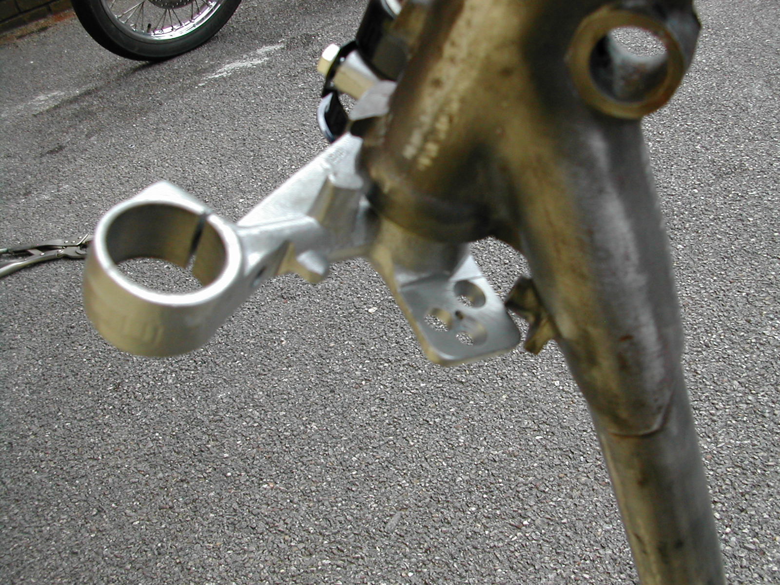

#86857
Up to a point they fit, but after 2002/3(?) watch out for changed the steering stops and steering lock mount.
You can play mix and match with the head races but this is what happens with the **later** Indian steering stem/bottom yoke in a Redditch headstock.
#86860
In fairness, it's a bit of a lottery anyway. Even if you put an Indian stem on an Indian frame. There is still variation in the location and size of the bump-stops. Not sure what this yoke was supposed to be off... Wish I'd thought to check fit BEFORE I had it powder coated, although superficially it looked the same as the old one.
Not an insurmountable problem, but annoying.
