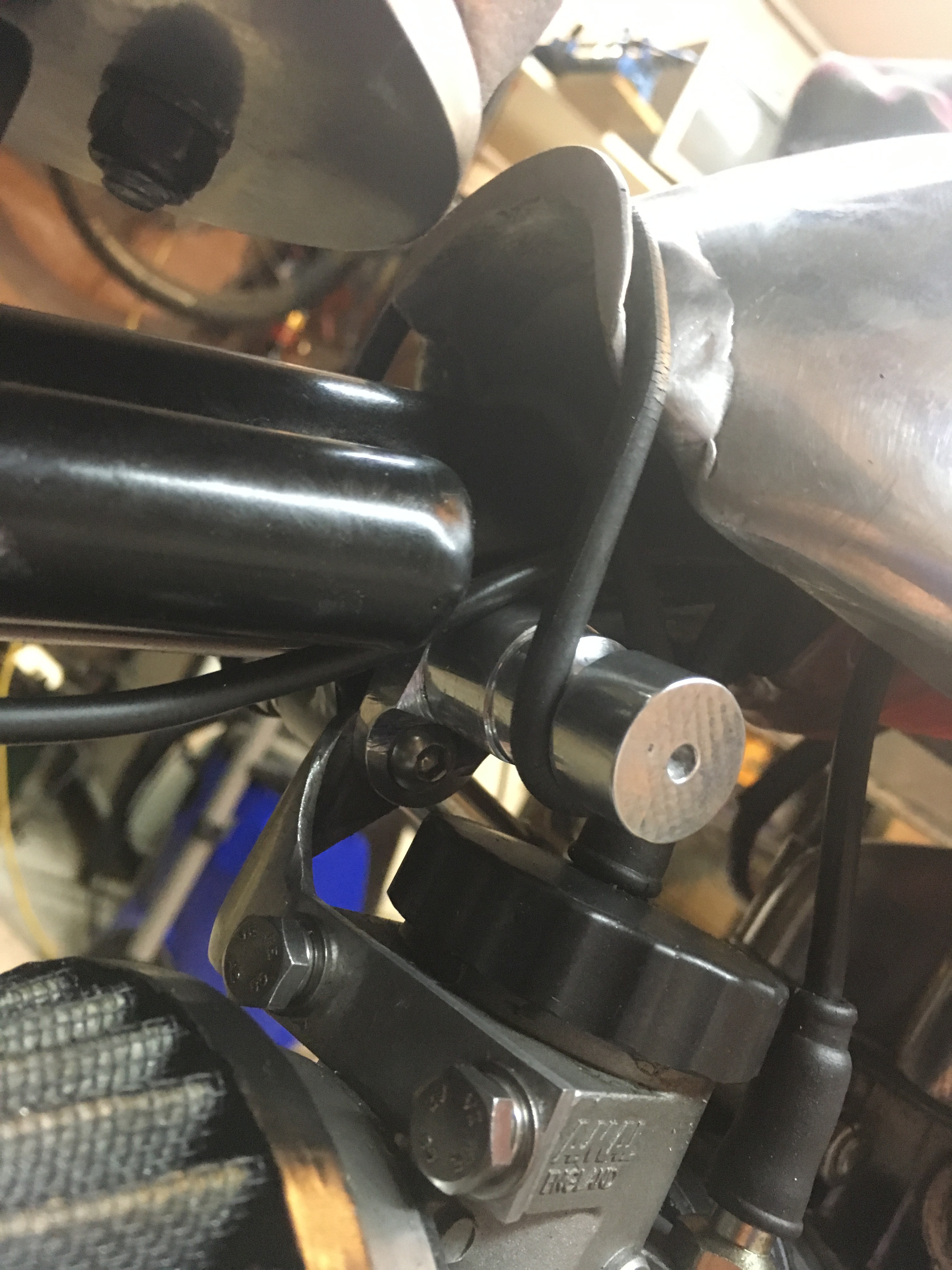

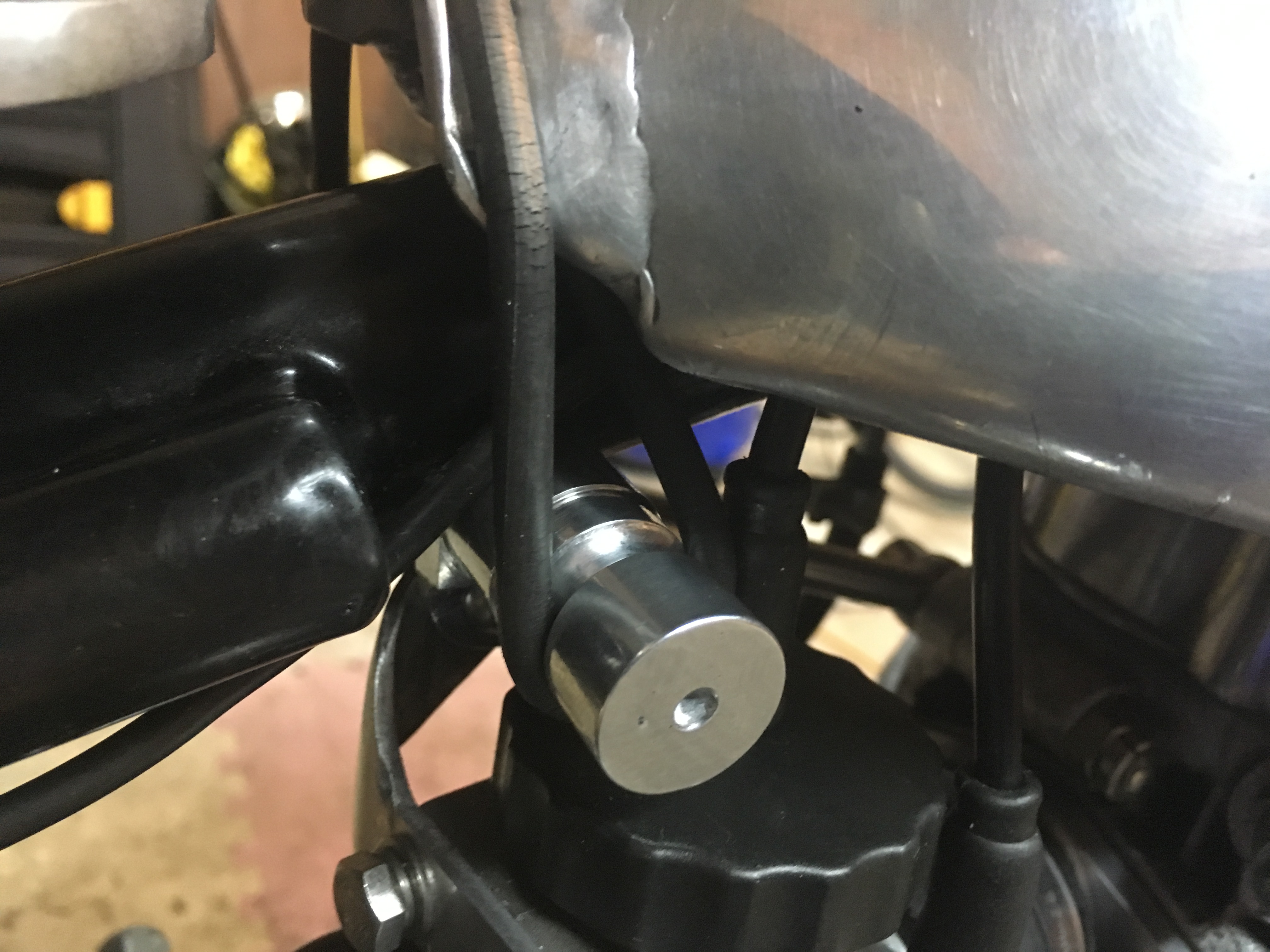

There are at least two issues in fitting an Amal MK2 carburettor and S&B air filter to the 500cc Bullet.
Firstly, the top of the carburettor can clash slightly with a mounting lug on the frame. so you might need to grind off 10-15mm.
Secondly, there is too much weight in the carburettor to be satisfactorily supported by the rubber manifold, causing the carburettor to vibrate badly, and causing the rubber manifold to fail prematurely.
You might need to fabricate a bracket to hold the back of the carburettor.
