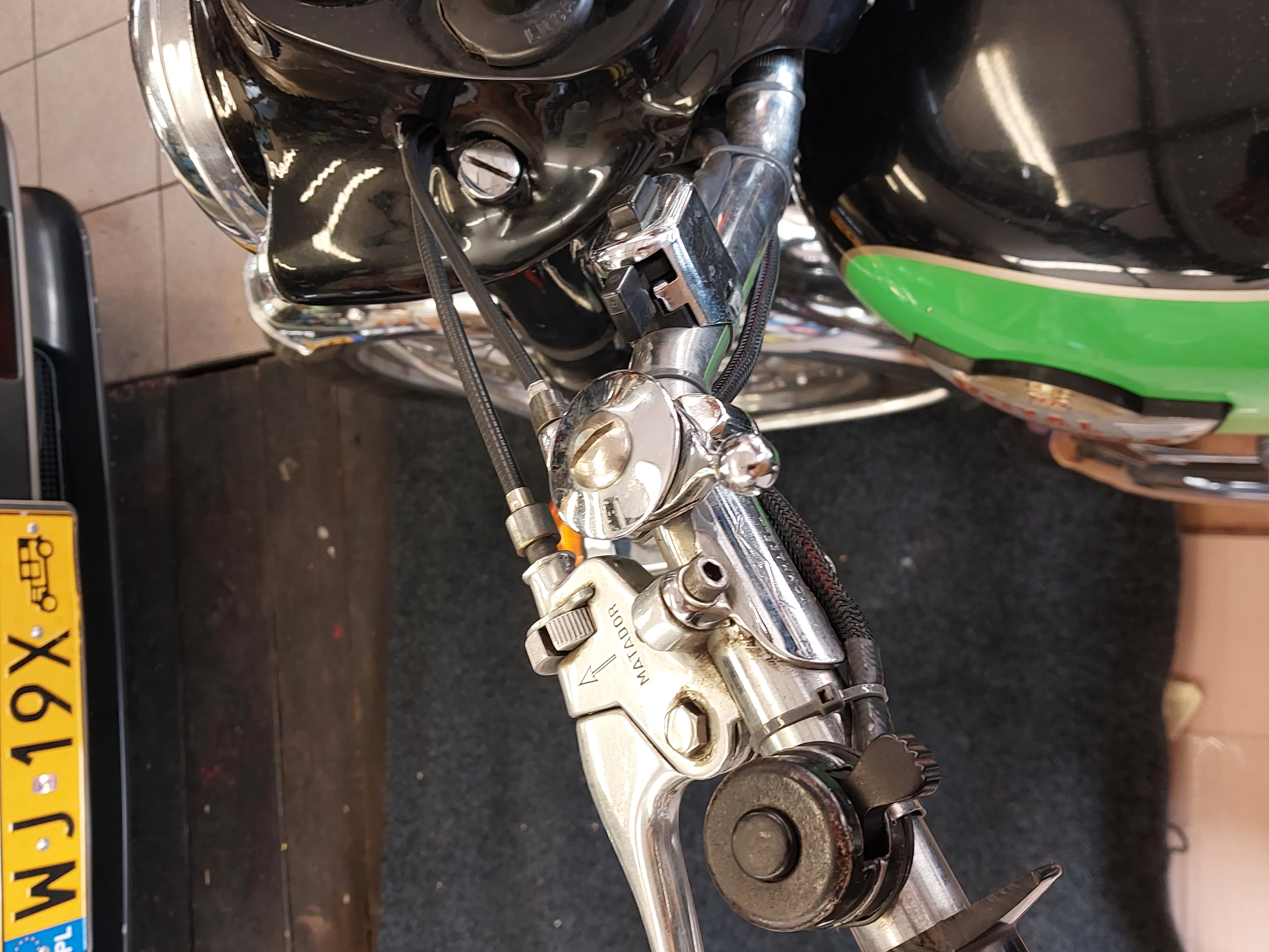

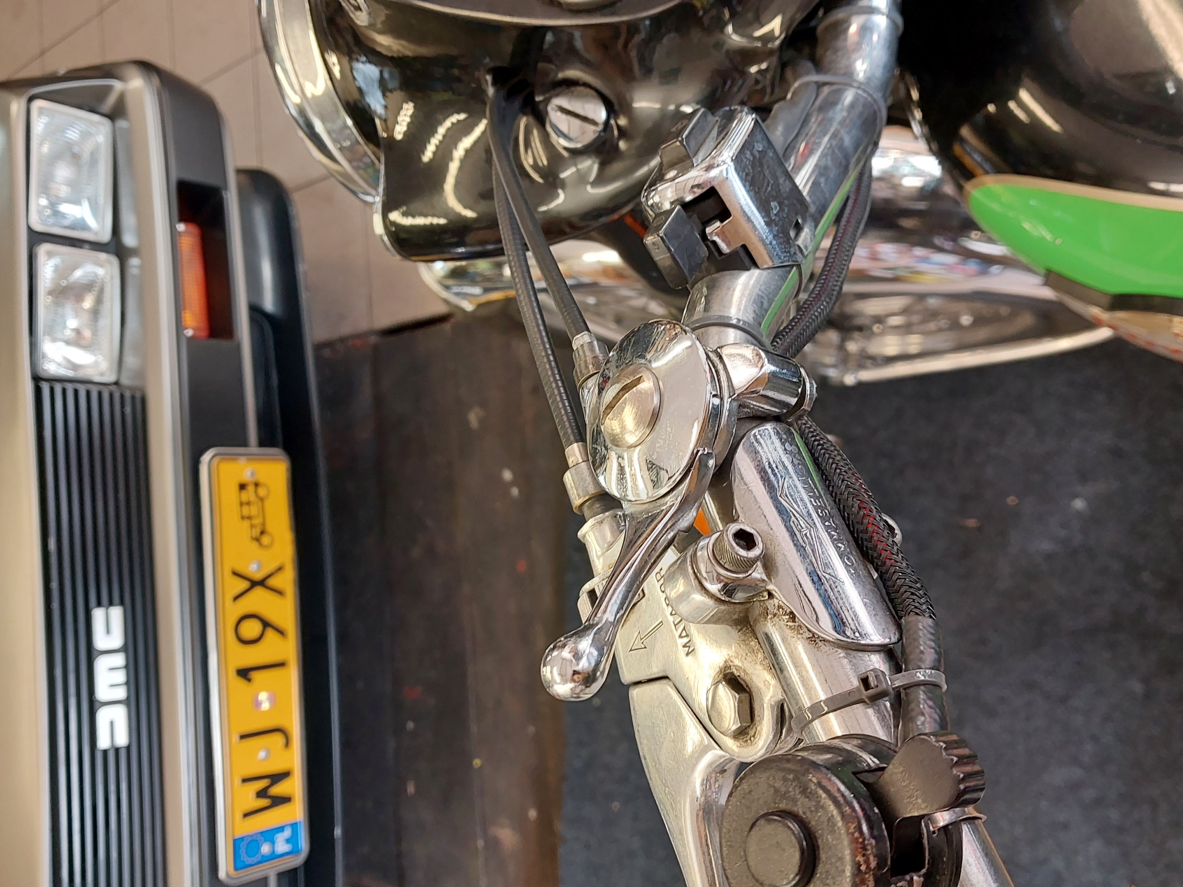

Personally I wouldn't consider doubling 11,1 being 14.
As for direction of ignition advance lever
Retarded
Advanced
