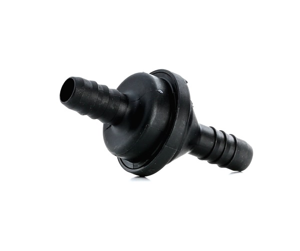

Sort of did that on the Constellation, instead od Indian Breather I've used one way valve, pictured below.
Now, when just slowly cruising, admiring the surroundings it works fine, but if bike is driven slightly more enthusiastically it's definitely not up to modern environmental standards.

Good idea. Will do. Also I got three one valves pictured above, going to use them in different places will se how it goes. Preliminary activities point to blocked one way valves just below cylinder. Replaced them with older design outlet.
