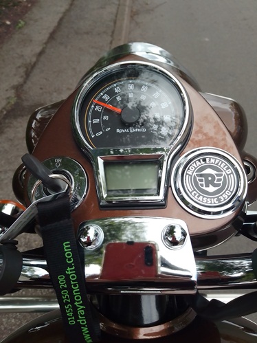

Nearly 500 miles and mine is still playing up too. Having had a good look at the speedo I can't see how it can be the glass affecting the needle as there is quite a gap between them. Whatever the problem is, Enfield ought to be looking at it. Has anyone contacted them direct?
Here's a photo of mine after stopping, ignition off but still showing 25mph.

The interceptor 650 Speedo has a problem with misting that a number of owners have reported.Replacement Speedos haven't cured the problem.A year on there is still no solution as far as I know.

This could be something simple like the Speedo cable/drive sticking or not making properly.I know it's under warranty but if you are mechanically minded it wouldn't take long to find out.

Out of the blue I had a call from the Royal Enfield importer yesterday - they are aware of the issue with the speedo needle. Re-engineered clocks are now making their way to dealers for warranty replacements.
The fault is indeed caused by hot weather. When I queried this and asked how come this happens for bikes designed to run in India, the Royal Enfield chap said the problem was caused by how quickly the weather changes in the UK and goes from extremes, whereas in India it is hot all the time hence no issues.
Anyway, hats off to Enfield for sorting it out and, in my opinion, some excellent customer service.
What utter nonsense, ask him what temperature the snow is in upland India. Have a look on YouTube at some of the motorcycle travel videos in India and see the temperature extremes.
